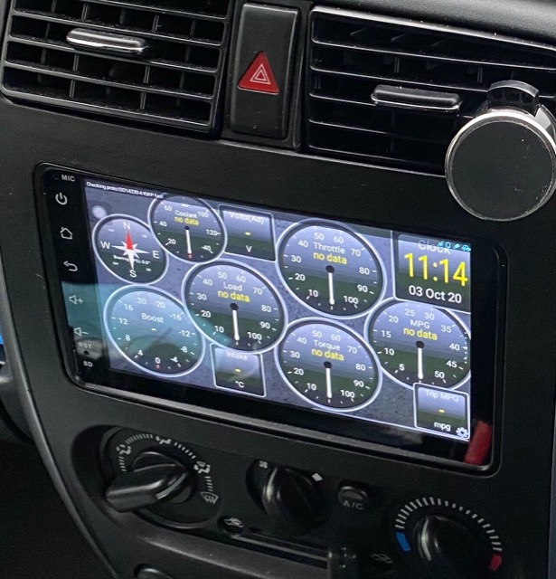

Torque Pro on my Jimny.
Fault codes and O2 graphs are on other screens. This is my normal keep an eye on things whilst driving screen, just the odd glance officer.
Torque Pro will let you clear codes as well.
