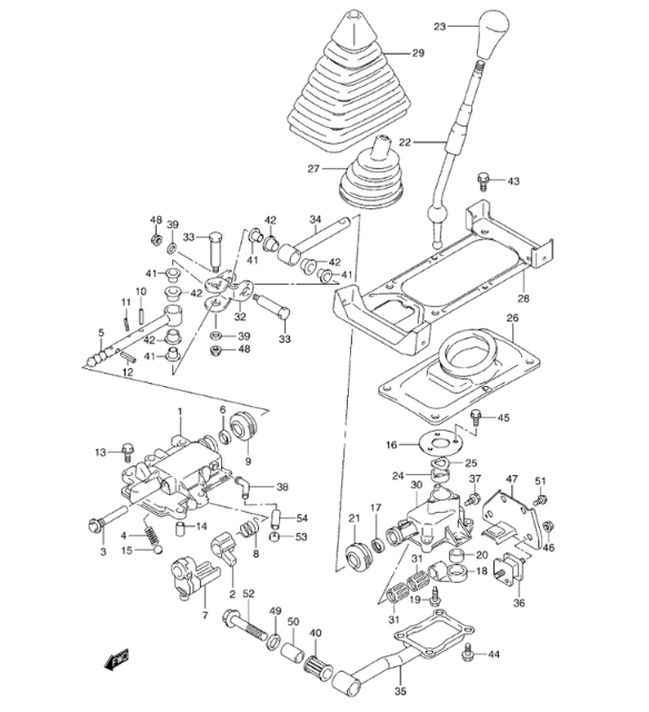

I recently changed the gear-lever bush at the bottom of the lever , which has improved it no end , but obviously it's must've been worn for a while and the spacer/ bush at the top is worn grooved and the movement .
I can find a part number or replacement name for for it .
item number 24 and 25 as it is distorted .
any ideas .
any ideas .

Having fitted a new bottom bush , a new washer from Martin there is little difference .
It feels like there is a lot of travel on the lever as in when reverse is selected it needs a little touch more .
Does the actual gear-lever come apart ? The big bush under the wobble washer is shaped to fit lever but the this is almost square so offers no line up to gears.
would it be easier to get a whole new lever?
