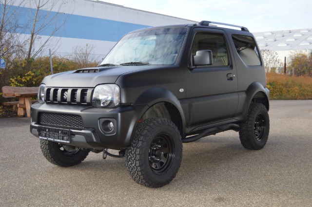

Going for something like this
If you take the time to give me your advice I'm grateful . DB
