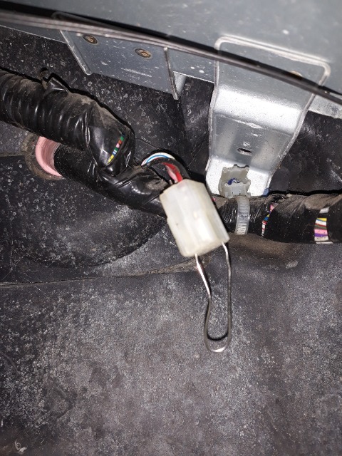

Ok Found the info on the interned good but not comprehensive. So took a spin to my nearest Suzuki dealer. Asked if they could please read my fault code for me. Yes €55 and we will book it in. I declined. Came home and changed the Fan and PAS Belt. Had another google and had a stab at the CEL check engine light and it worked here's what I did.
Look under the glove box and you will see this note the white 6 pin plug in the yellow circle.
It is very awkward but if you slide the passenger seat all the way back you will manage to get your head in under the glove box.
A close up of the 6 pin plug
This is an extract from rhinopowers web page
So I rotated the 6 pin plug in my hand so it looked the same as the one in the Rhinopowers sketch and popped in my paperclip.
I then crossed my fingers and turned on the ignition and hey presto the Engine warning light blinked 3 times then a pause and one giving me a 31 fault code which translates into a Manifold pressure sensor problem.
Here is the link to Rhino's excellent work and info and fault code meanings. www.rhinopower.org/diag/cel.html
Now to find the cure for the Manifold pressure sensor fault. Hope this helps you in the future. J
