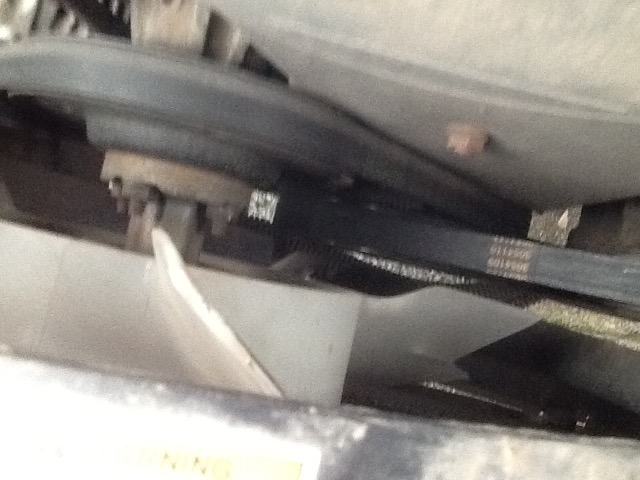

A few weeks ago , my missus mentioned that there was a horrible noise so bad that she searched for something being dragged underneath.
It reappeared a few times but never when I drove it . Once I heard summat that sounded like gears not meshing.
Christmas Eve she was going up to the stables but the noise returned , this time followed by a constant ticking sound. So she parked it up and walked .:S
Now I have thought for a while there has been a smell of hot oil when we get back from the stables, but the oil is fine both level and quality .
Today having time off in the daylight ,mission find out what the issue is .

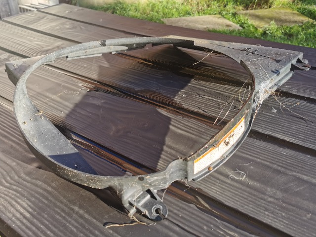

Yep the fan cowling has become unattatched at the bottom and the noise was it being reshaped by the steering pump belt!:ohmy:
The following noise was the fan remodifing ( breaking bits off).
A bodge solved it for now .

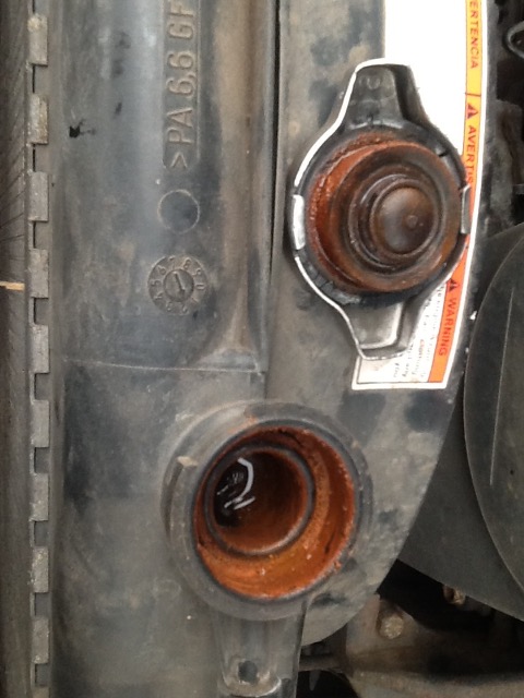

It's has clearly been running hot , so I thought I'd better check the cooling system. :dry: now comes the embarrassment , the rad cap was gummed up as was the overflow channel and vent pipe. So how come it showed no signs or objections, or ill effects .
How easy is it to source a new fan and cowling.?

That's one gummed up radiator cap. May be worth a flush of the radiator to give it a clean.

Had a quick look and parts are readily available , but first I just need to check will a fan and cowling from others fit a GB13 engine from a soft time ?

You need to remove the thermostat and flush the whole system with a hose. That mess indicates zero anti-freeze.

Re antifreeze this is the odd thing I checked it with a hydrometer a few months ago when I checked all the vehicles ready for winter and it was -30 , not a nice colour granted , I have had this vehicle for 18months of so , it gets serviced and bits done as needed as do all 3 of the Jimnys , and they are worked . What antifreeze should be in there ? I know Toyota need the red stuff as it reacts when mixed , is this the same in Suzukis?
