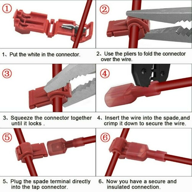

Hello fellow inmates!
Happy to say my '05 flew through it's MOT with just an advisory on the SA80 quick release clamps....
Anyhows, I honestly have not seen these before [a bit behind the times?] but they would have saved me a bucket load of
hassle over the decades!
preview.tinyurl.com/y4rob5yg

Been around for quite a while in one form or another, the favourite of the quick connection goes by the name scotchlok.
They can be devil's own in automotive use as over time they don't perform that we'll, leading to broken or poor electrical connection.
The main issues are that it's not watertight and can corrode, It also gets mismatched to the cable size by the user. If placed and used correctly they do work, but more often they are inappropriately used leading to issues later in life.
Me, I won't touch them. I splice solder and heat shrink all my automotive T connections.

I personally do not like these, because they tend to make trouble that is then hard to find. They damage original wire and the connection is not very good and in case of corrosion any fault is hard to find.

When I was fitting alarm systems, I avoided these like the plague. Poor connection at best that quickly corroded and caused high resistance in the circuits leading to intermittent and then total failure.

SA80 quick release clamps! :blink: You've rifle racks fitted?:whistle:
Yep scotlocks a useful temporary fix ...but after a while the ingress of water can cause you to meet interesting people, usually belonging to the recovery services ... Oh and a French ferry shunter driver who will drag your sorry alternator less people carrier on to the ferry at speeds not assocaiated with towing on a webbing strap!:blink:

Still believe in the old way to wire tap. That way i know a fault is not at a connection that I made or where i spliced into a wire as they will be properly soldered in. These crimps leave you stranded when you least expect it.
