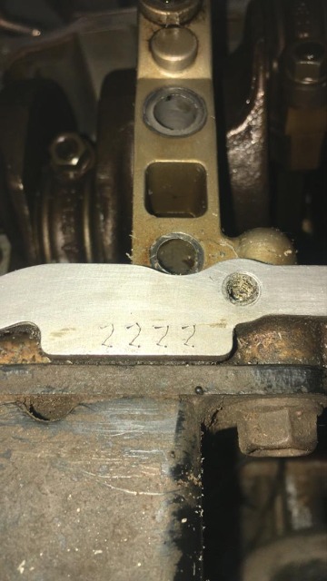

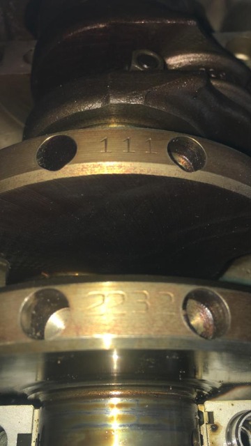

Here are some numbers from a 600cc engine
Does anyone have the info on decoding these to colours as they do not match the 1300cc tables

You set off my natural curiosity Martin. Like Chris, I was able to find info for motorcycle engines but nothing for the (I assume) JB23. The only information I found concerning the 600cc Jimny talked about determining bearings by taking measurements. The manual here
K6A Manual
is not specifically for a Jimny so not sure if it is helpful.
