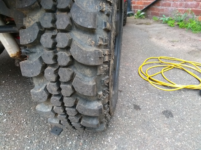

Replied by jackonlyjack on topic 16" steel rim options
This is a 195/80/16 7" rim
It doesn't offer much rim protection
Why don't after market wheels come with rim widths like they used in the 80's

18 Aug 2020 12:05 #226899
by Roger Fairclough
Replied by Roger Fairclough on topic 16" steel rim options
205/80/16 is equivalent to a 205/16 as the aspect ratio when not stated is 82.The recommended rim for this is 6J with limits of 51/2J -61/2J
