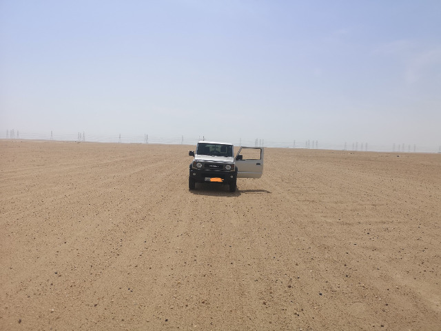

Hello everyone! This is my first post on this forum and I come to you in a time of great need, I need some of you jimmy veterans to give me some technical advice on what to do with my first jimmy, and first car. (below I've attached an image)
There are two retailers in Kuwait, where I live, that sell Jimny accessories, one sells the old man emu 40mm lift kit, and the other, the 50mm Ironman 4x4 kit, anyway- I ordered the old man emu kit initially but cancelled after a friend- who owns a nearly fully modified jimny told me that it doesn't come with a steering dampener, or they don't sell it with one rather. This is problematic for me as driving on extremely soft sand in the desert for extended periods of time in the jimny, can loosen the steering column and make some awful sounds in the process, as is with my experience.
I canceled my order of the old man emu kit, and opted for the ironman4x4 kit but have yet to pay or install it, and after digging through this forum I'm getting second thoughts, based on other peoples experiences.
I'm worried that giving it a lift will affect it's performance negatively, adding larger tires paired with the lift might affect gearing and fuel consumption, which for me, the jimny is my daily driver, and I would say it's on road for about 80 percent of the time. My main reasoning for getting the lift would be to mitigate the terrible roads here, road bumps, pot holes, etc, make it some what laborious to drive the jimny, so getting better coils, shocks, and bushes would fix that issue.
Moreover, when I do go offroading, I often times have to follow washboard roads, which in the jimny's stock form, is unbearable, it feels like a washing machine and that the rear end of the car is going to take off if I drive faster than 40km/h (as seen here)
So bearing all this in mind, my problem is that I want the jimny to be more comfortable on and offroad without compromising safety or performance. off-roading, the number one problem the jimny faces is the occasionally getting bogged down in sand, and sometimes getting unbogged without any recovery gear can be stress-inducing. Though I think more aggressive tires and a steering dampener can help in that regard, I'm afraid all the extra weight will make it even worse.
Finally, I'll be posting the contents of the entire kit (sold from the retailer, not ironman4x4) and curiously I noticed a lack of extended break lines? I'm not sure, a lot of you know more about the technical aspects of lifts and the jimny in general than me, so bearing all I've said in mind, advice would be greatly, and deeply appreciated, cheers.

and a few pictures of my car
