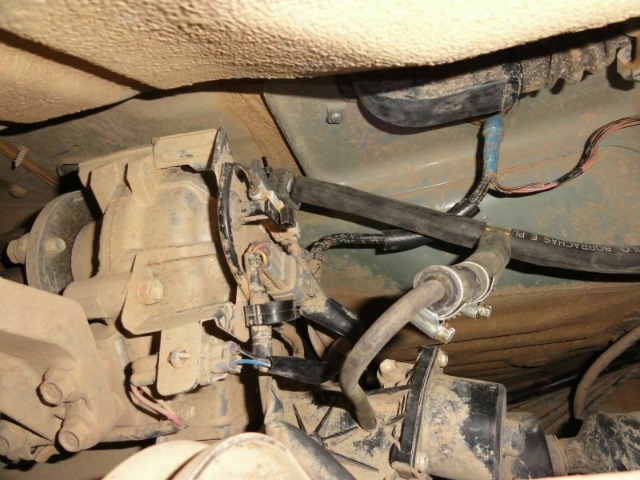

Anyone out there got an electronic / solenoid / button shift transfer box, with a breather kit on it?
I just had this photo sent by an eBay customer -
Which shows a "rubber hose" installation of a breather kit... but there's a T-piece and another hose going off to a breather on what I presume is the solenoid / actuator on a push button transfer box?...
Any experience folks?

Yes Dave, as Jack says, just done it.
Top breather for the transfer case used a 1/8th BSP 90 push fit to a push fit T. The T goes to the shift actuator and the manifold...
I'd get a picture but it's very wet, will do it in the morning if needed....
sniper

I should have seen this post before but I was busy in the garage. I was still under my car an hour ago...
Push fit breather kit is installed to my button operated transfer box.
bigjimny.com/index.php/forum/18-build-th...0-transfer-box-flush
Only difference to Sniper's setup is that I did leave the tiny breater pipe (actuator) as it came from the facory, and only connected the top breather with push fit system.

He's bought the kit, plus an add-on for the transfer box, and two gearbox add-ons, so as Sniper indicates, he's going to use a T-piece and a short section of tube to go to the actuator breather like in the rubber hose photo above...
I'll ask him if he'll take a photo of it when it's fitted...
