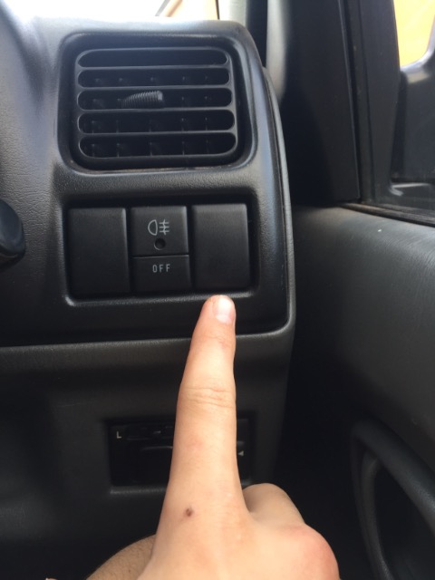

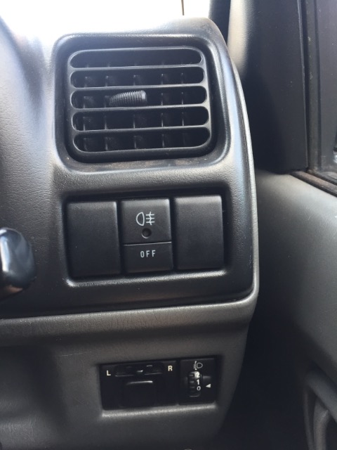

Hi all, I am new to the Jimmy world and have got it for a first car. I love it. I’m looking to put some fog lights in the front but the only bit I’m unsure about is the switches on the right side of the dash under the vent, where do I get switches from and how do I install them there. Thanks

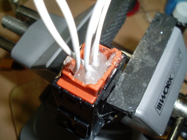

Note, the 2nd hand switches do Not come with a connector block(s) so you will need a thin tip soldering iron for a start!

You can also look at e.g., AliExpress.
The only problem was that the color of the illumination was yellow and I had to change the bulb to a small red 12V LED.
And I would get a 5pin one so that there is an on-off light and a night illumination.

In my 2015 the cabling for the fog lights was already there. So there was the plug already there and the cables to attach to the fog lights.
Maybe it is the same for your car.
