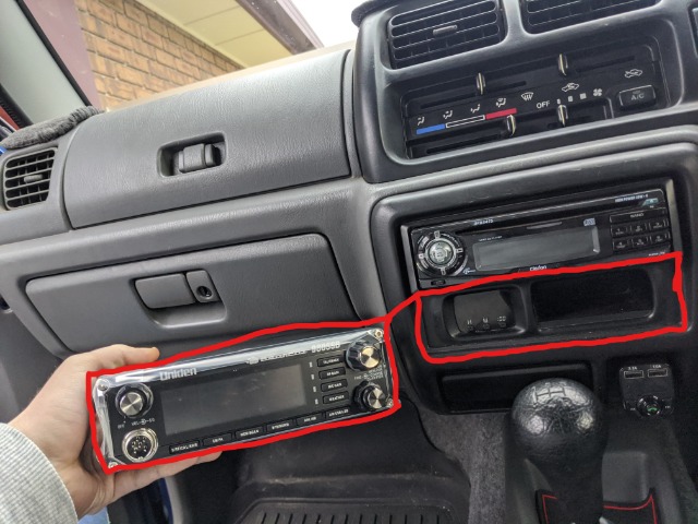

Hi everyone,
I've got a 1999 Jimny with the pre 2005 dash. My plan is to fit a single din CB radio beneath the single DIN head unit, replacing the clock and empty slot. Is it possible/easy to use the clock wiring to power the radio? Is this a good idea?
I know it's possible to fit a second single din block there (see quoted post), but my question is more catered to the wiring.

The clock wiring is so thin......but it would possibly work out ok
I use power direct from battery with in line fuse next to battery
This way if anything goes wrong with the car electrics and you loose power
Your cb will still work so you can call out for help

It's been 40 plus years since I had a CB in my Land Cruiser and haven't kept up with (and don't remember) the power requirements. For my Dual Band mobile, the power source is supposed to be capable of at least 20 continuous amps. If your CB is even close to that, the lead wire for the clock wouldn't be able to handle that.
If you want the CB to have power when the ignition is on, I would tap into the cigarette lighter for a relay that would connect the CB. Once you do that, follow the wiring that Jack mentioned except for running the CB power lead through the relay. Alternatively, you could do exactly as Jack outlined assuming you have a good enough memory to power off the CB each time you leave the car.
