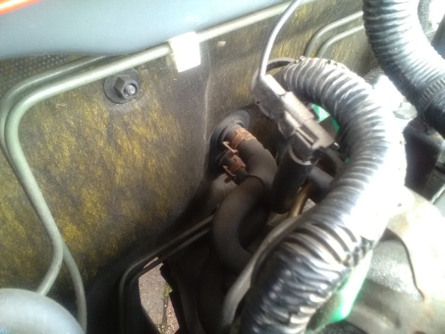

If it's not an air trap or heater control as above ^^^^ it's possible the matrix is blocked. You can try flushing with a hose pipe by removing the heater matrix feed pipes, but it's best done during a coolant change as you are going to loose coolant in the process. The matrix feed pipes are shown in the photo.
These should both be hot if water is flowing into the matrix, so you could have a feel and let's us know if they are warm or not.

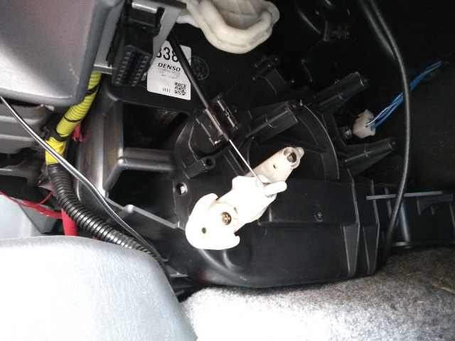

Hi Jack, Thanks, the heater control under the dash, should it be 'one' unit, (the two bits linked together) mine is two bits - the top and the bit with the wire aren't joined together?

Replied by jackonlyjack on topic Air lock in heater pipes?
Yes should be linked
In this picture you can see a the pivot point
This picture is set to hot on heater
