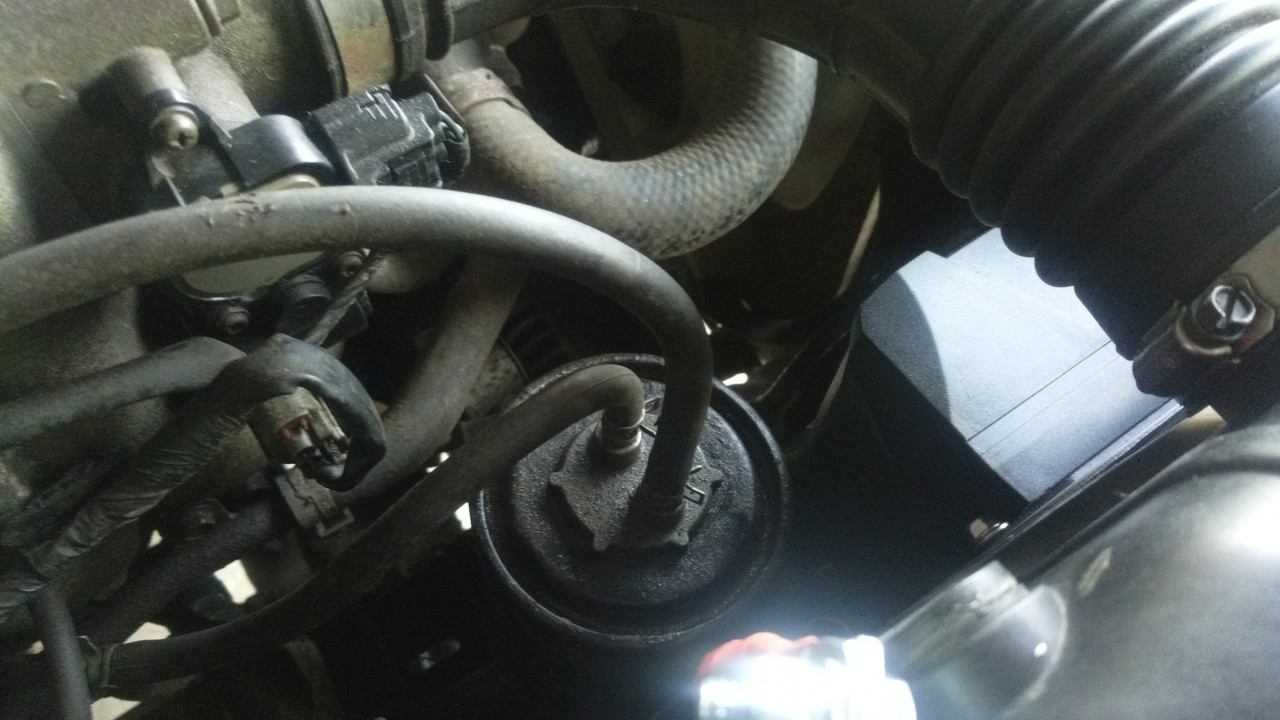

Not sure what this is?

Replied by Lambert on topic Not sure what this is?
I must have spent too much time in the sun yesterday. Sorry.
This is a vacuum reservoir (image stolen from the internet)
31 May 2020 06:33 #223043
Replied by Riccy on topic Not sure what this is?
Its an evap canister for the fuel breather. It has vac lines because the ECU 'purges' the canister when the engine starts briefly.
I would expect ECU issues if its removed (its gone on mine, but mine is running aftermarket ECU, intake, etc).
- Reason2doubt
31 May 2020 17:42 - 31 May 2020 17:45 #223075
by Reason2doubt
Replied by Reason2doubt on topic Not sure what this is?
Interesting....
Better find the item in question and put it back....
Yes single cam early Jimny.
Thank you Riccy!
Thank you Riccy!

- X8GGY
31 May 2020 19:48 #223083
Replied by X8GGY on topic Not sure what this is?
Yes, I have one of these n my early (X-reg) Jimny based buggy build too -
Here it is dangling as all the outer and inner wings have been removed, so I need to make a mount for it that will stand on top of the spring cup on the chassis...
Mine too has two small rubber hoses that run into the fuel intake area...
And I'm in the middle of adding a hose and breather tube to the port in the bottom of this "charcoal canister" as it vents to the atmosphere?
- Reason2doubt
31 May 2020 21:49 #223087
by Reason2doubt
All sorted and it's back in now - I think I might consider trying to find a new one as this one seems a bit battered by corrosion.
@X8GGY - I noticed that too. I spent a little bit of time trying to figure out if there was a pipe somewhere which had possibly fallen off but it does appear to just be left with nothing attached.
- X8GGY
31 May 2020 22:00 #223088
Martin found this from the FSM (Factory Service Manual) of how Suzuki Dealers should test the charcoal filter canister -
Indicating the bottom 'port' is vented to the atmosphere... and could possibly fill with water if the vehicle was submerged for a long period of time, hence why I thought I'd add it to my breather setup...
