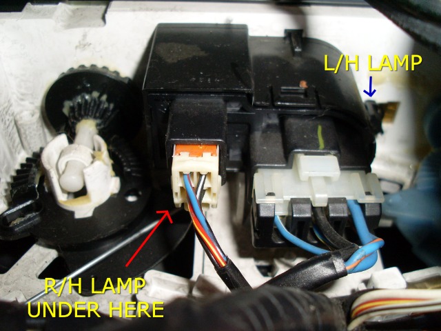

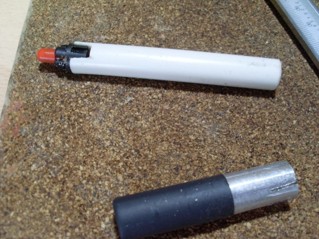

Had the right hand bulb not working since I got the car so, while having the radio out in prep for swapping some switch functions around when Posty brings my bits, I decided to have a go! Got the left hand bulb out OK (struggled) and then couldn't even find the right hand one so, got the little mirror out and nearly gave up there and then! Couldn't see anyway of doing it without removing the Whole of the centre dash.

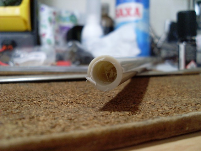

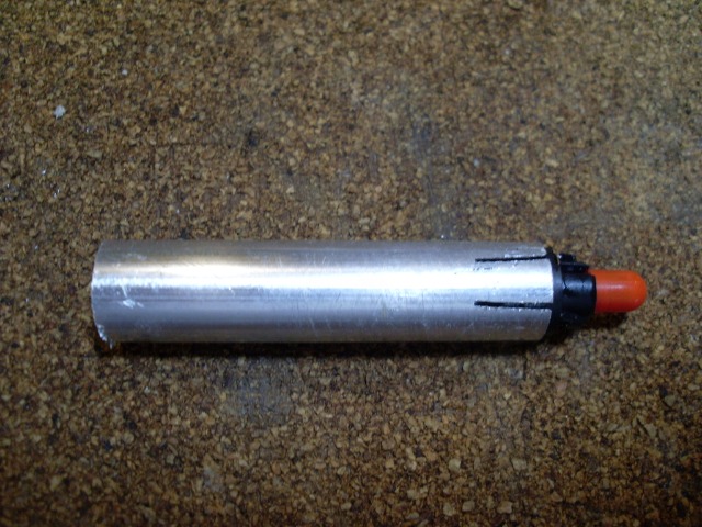

So decided to make a 'tool'
That didn't work, it was too short and had no way of knowing which way it was facing...

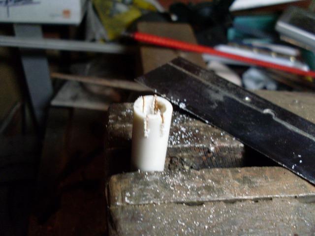

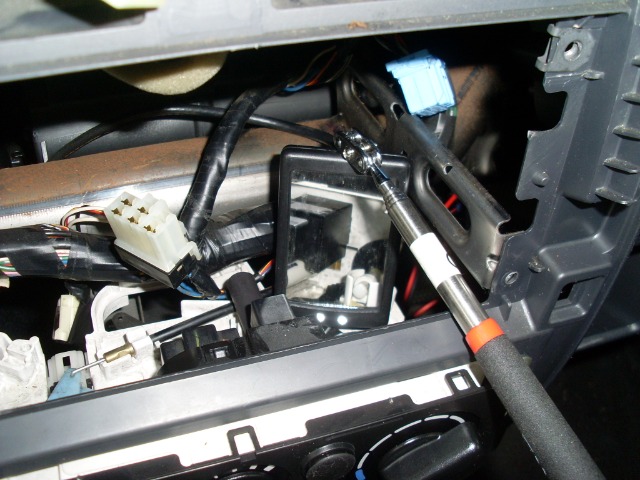

MKII

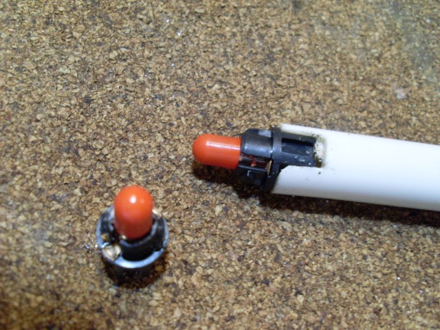

BINGO !
Put the good l/h bulb in the r/h socket and made sure it worked before I had a Pie...
