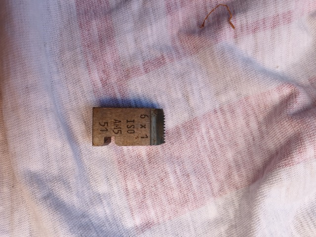

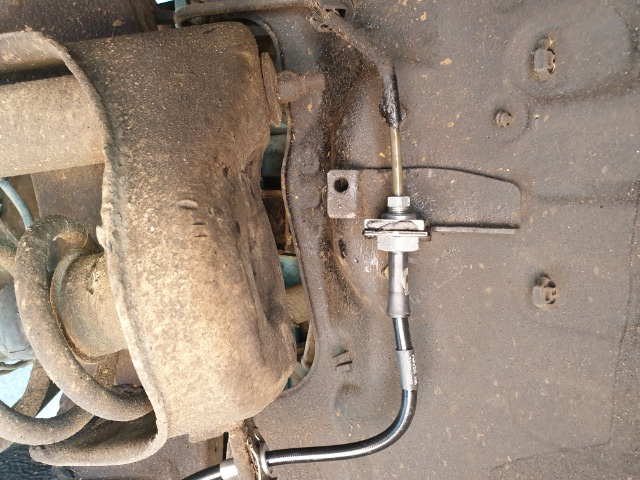

So it turned out the union on the drivers side must have been damaged on assembly. Luckily I had some dies for a die head, these are actually M6x1, but with the pitch being the same was good for cleaning up the thread along with a ratchet Spanner on the union. After cleaning up the thread it screwed in by hand as it should.
