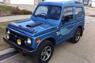

Hello,
I'm a new member from Alberta, Canada. Jimnys are quite uncommon here, so you'll forgive if this is a bit of a dumb question.
My 1992 Jimny here has an annoying issue. When idling or crawling around a parking lot, it seems fine. But when you demand any sort of power, it lugs like you just slammed it into too high of a gear. But in neutral and at low speed, you can rev it to the moon as per usual. Something is choking it or holding it back. The only time is approaches normal function is in the tiniest little "sweet spot" of throttle, where it will twitch and jerk and attempt to pull as it should..
Initially I assumed the crusty old fuel filter that the previous owner never changed was the culprit. But I changed it, ran some fuel line flush through, and nothing really changed. I don't suspect an electrical issue, because the motor is ticking over fine, and I don't suspect some of the more outlandish ideas I was suggested by people elsewhere, like the timing belt or fuel pump. The odd behaviour of the throttle and the "choking" just screams "fuel issue" to me.
I was thinking of swapping the fuel regulator next, but I was hoping to get some advice/opinions elsewhere here before spending even more cash on this car (since nobody in the country carries Jimny parts). Any feedback would be appreciated. I'm starting to go a bit nuts here. It has the 660 Turbo, with only 60,000km on it, it shouldn't be failing this hard this early.

Hi Tok, Without sounding vague the issue could be multiple things. The Jim looks very tidy, so I'm assuming the motor has been equally cared for?
