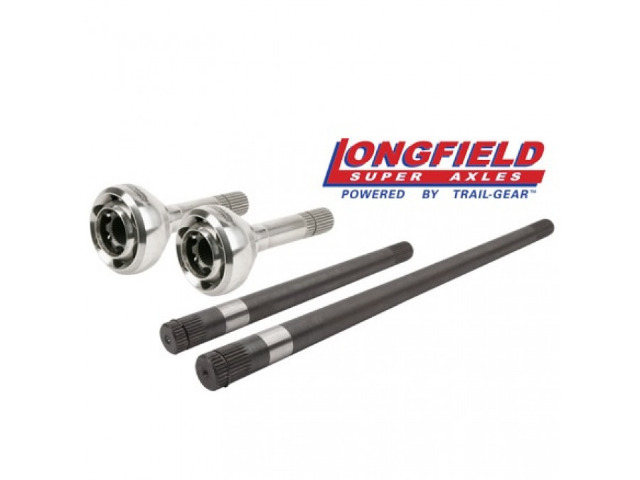

Thanks Lambert. The TrailGear axle kit is the half shafts and CVs. This is what I am looking at:
This kit applies to 15 years of production and I have no reason to think it wouldn't be common with the last 3 years. It is only the fact that they list these for years 2000 - 2015 that I am a little concerned. The likelihood is that those are the only years that TrailGear (Longfield) had data for. I still recognize that the other years (and maybe some of 2015) might possibly be different. That concern is compounded by the fact that the RCV kits also show compatibility through 2015.
