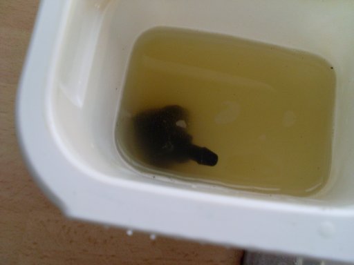

Give the components a good soaking in vinegar - if there's any limescale blocking the system, that should dissolve it.
I've had it happen to me and the vinegar fixed the issue

Thanks Max! will pull off the tube to the jets, drain the water and squirt vinegar in there and leave it to soak..

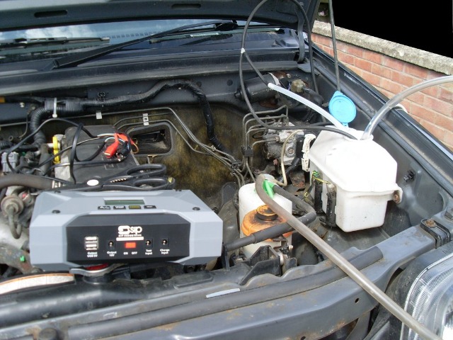

19 Apr 2020 15:53 #221275
by TillymintDLG
Replied by TillymintDLG on topic Re:Re:Washer pumps performance
Hi Max an update, disconnected this and that and hardwired the front washer pump and pumped some ACV around the system to clean/check the valves etc, then took off P side nozzle, soaked that and raised the jets a bit. put all back together and all fine now, even the rear washer is better now!
Cheers for all the help!
Gaz
Gaz
