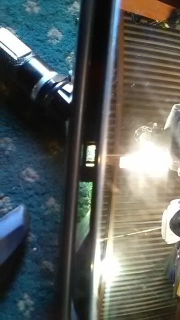

Here is the lower clip hole visable from the mirror side
Easy when you know how.
Mike
