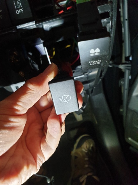

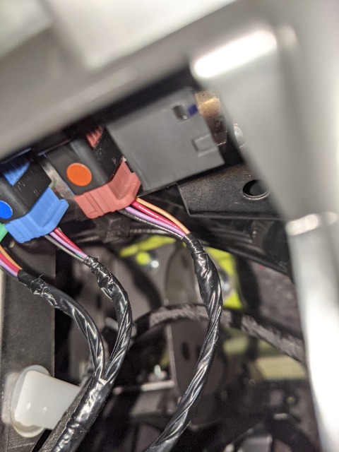

I managed to work out how to remove the front panel and have taken a picture of the wires leading to the switch.
I was hoping to find a red with yellow stripe wire, but sadly not.
If you do get a chance to have a look that would be great, as I really want to get this correct first time. Of course don't worry if you haven't got the time.

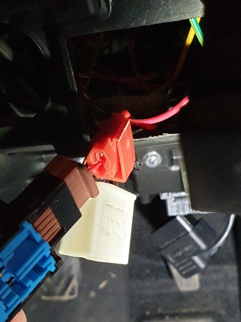

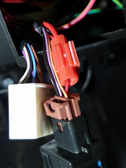

Well I thought now or never lol, busy day tomorrow and out doing some lanes on Saturday and camping out, so why not.
I spliced into the Red wire for the Headlight Washer switch (just because it is the nearest) (forgive the scotch-lock )

20 Sep 2021 13:52 #238824
by Jazza
Replied by Jazza on topic Gen4 Jimny Service manual
That was quick! I went away camping shortly after I sent my last message, hence the late response.
Nice clear pictures, this is exactly what I was after, I cant thank you enough!
