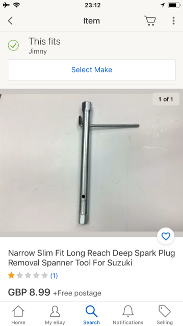

Replied by Stock682 on topic first time doing a service by myself
Double ended spark plug spanner giving both 10mm (16mm Euro) and 14mm (21mm Euro)
300mm Long and 28mm wide.
This is the one I need??? Thanks in advance!
- Posts: 9311
- Thank you received: 1865
30 Mar 2020 04:35 #220455
Replied by Lambert on topic first time doing a service by myself
My 3/8drive bahco mini set 16mm plug socket slides just nicely into the head and allows the use of a suitable extension to get to number 4 cylinder which is a little obscured by the fire wall.
