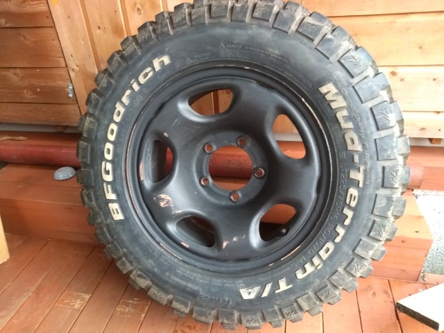

29 Feb 2020 15:54 - 29 Feb 2020 16:01 #219223 by jackonlyjack
Most off roading is done a slow speeds so impact pressure is low
Any rocky sections can and will cause damage
Alloys don't rust when paint is damaged steel does
I use 16" grand vitara steels
This is damage from one day on the lanes in the lake District
Last edit: 29 Feb 2020 16:01 by jackonlyjack. Reason: Add pic and text

29 Feb 2020 21:03 - 29 Feb 2020 21:06 #219226 by StatusRed
Replied by StatusRed on topic Which wheels for offroading?
Lambert wrote: Steel wheels are no less likely to take damage than alloy ones but it is possible to beat a steel kinda back into shape with a big hammer out in the Bush which you simply can't do to an alloy wheel. But you need to have the provision of potentially unmounting a tyre and having a big enough hammer with you. In reality your best bet is a high profile tyre that way the actual wheel is as far away from damage as it reasonably can be, that and pick a line on the track that is more likely to keep you from smacked rims.
But alloy is more susceptable to cracking right? It takes less force to damage / mishape / crack an alloy than a steelie, doesn't it?
jackonlyjack wrote: Most off roading is done a slow speeds so impact pressure is low
I like the look of those steelies. Appreciate that steel will rust, but alloys still corode and are suspcetible to acid attack, isn't this more then more likely when the outer coating is stripped off, as it would have on your same outing when paint was scraped on your steelies?
