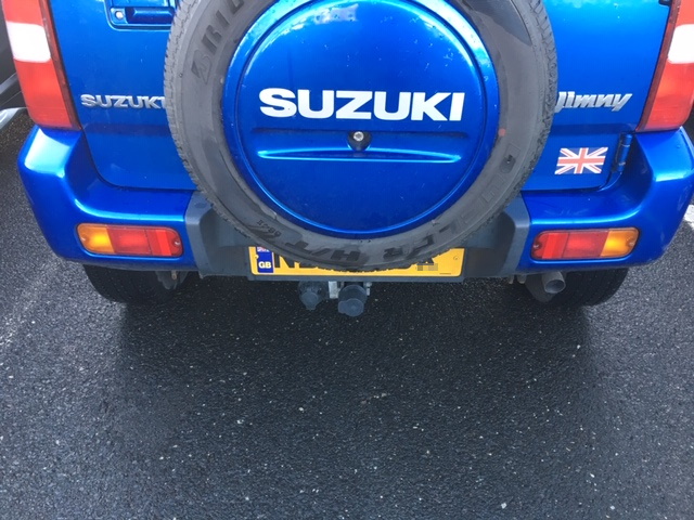

No eBay APP ID and/or Cert ID defined in Kunena configurationI fitted a tow bar to my Gen 3 last October. Most makes seemed to be out of stock (including Witter), so ended up with a Umbra Rimorchi (UR) from eBay (biggiddygiddy) for £129. It is excellent and includes a long detachable swan neck (not shown in the ad) and was easy enough to fit, the electrics probably took as long as the tow bar.
It came with a nice cloth bag to keep to tow hitch in and fits in the small tool tray in the boot. There is even a plastic cap for the tow hitch socket when it isn't fitted (also not shown).
It is rated for the full 1,300kg (braked trailer), so easily able to pull a small box trailer. It doesn't hang down too far and fits under the bumper so you don't bask you shins on it.
Overall very satisifed. I would have had a Witter, but they are a good deal more and were out of stock when I wanted one.

Just thought I would add a couple of pictures of my UR tow bar. The swan neck ball joint is not fitted and you can see the plastic cover over the ball joint socket.
