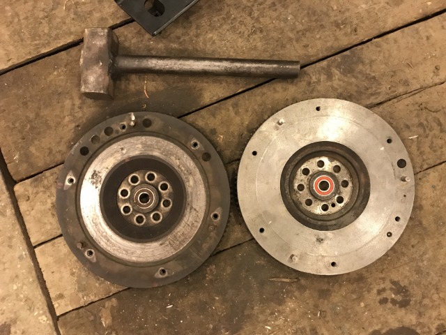

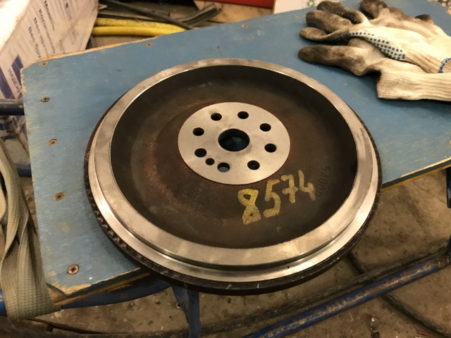

I did it with cutting flywheel.
www.drive2.com/l/551895464589394634/ (use google translate, it's on Russian)
Cut 3.5mm working surface and 1.5mm back (closer to engine). Total weight decreased about 1 kilo from 7 kilos to 6 kilos (Jimny flywheel is 6.5 kilo).
Now I have bought another flywheel to experiment with solution as OldBlindDog said. Cause it feels that flywheel is too light. Although it is ok to drive more or less (m18, r7me with 0.795 from secord generation, 1.32/2.64, 4.09 and 235/75/15 MT)
