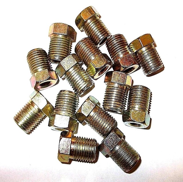

Most independent motor factors will make you one up
Price should be around £15
Just be aware they don't fit the wrong ends.you need fully threaded fittings
I they say other type will work IT will not

There are kits out there for some vehicles, but it was cheaper if I bought a flaring tool and cut my own from a length of Cupro Nickel pipe. Some kits are copper but its softer and probably easier to accidentally pinch, kink or crush.
The job itself was not difficult and I was able to route the pipes more neatly than the originals. Just don't overtighten the unions.
From memory, the tools I needed were:
A suitable sized pipe-cutter
A suitable sized pipe-bending tool
De-burring tool
Flaring tool.
Items needed:
Sufficient length of cupro nickel piping.
Sufficient amount of replacement unions and Tee-pieces
Sufficient amount of replacement rubber-lined P clips and support brackets
Bleed-tubes
Brake fluid
The biggest pain was trying to fathom out which type of flare was correct for my car - there are several. This is critical or you will simply get unions leaking. Several phone calls to various places eventually confirmed the correct flare tool needed.
Top tip - remember to fit the unions to the pipes BEFORE flaring the pipes!

It's not a difficult job replacing brake lines, the first issue is to remove faulty line and hopefully this will happen without snapping or rounding off the pipe end in the cylinder / union.
Once removed you have all the information to order unions / pipes to make your own, Google the flare type (bubble or ISO?) and get the correct flare tool. Cheap universal £9 tools are useless, expect to pay £35 - £40 for a specific fixed tool. I can send link to good ones if you want to make your own, or send you my (cheap) universal tool for free if you cover the postage. This is not a good offer, it's useless.
I like making my own and like Max have classic cars which share the cost of the tools.
Alternatively take the removed pipe to a garage or motor factors and pay them to make one for you. It's a £10 - £20 option.
Bleeding the brakes afterwards is a two people job, or you need an ezybleed or vacuum bleeding system to help, so another thing to consider if you have never done this.
Or just pay a garage to sort your brake lines out, it's cold outside and maybe the better (if more expensive) option. I expect £20 in parts plus 1hr labour, so about £60 - £100 ???
