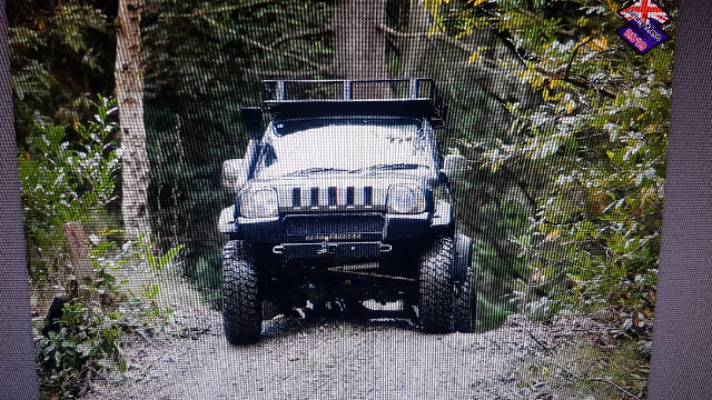

31 Oct 2019 11:12 #215247
by Keithy
Replied by Keithy on topic 3.5 - 4" lift few questions
- Jeep4life
31 Oct 2019 11:23 #215248
by Jeep4life
Hi Keithy,
Beautiful jimny you got there!
What is your lift kit included ?
I wonder if only corrected bushes will do or I should also get corrected arm for the rear.
What changes did you do in order to fit the 31 ? Regear?
Replied by Jeep4life on topic 3.5 - 4" lift few questions
Keithy wrote: I've been running a 4" lift and 31" tyres for the last 2 years and actually using it off-road....corrected arms and poly bushes and panhards etc.
No issues to report....very rare anything touches underneath.
Hi Keithy,
