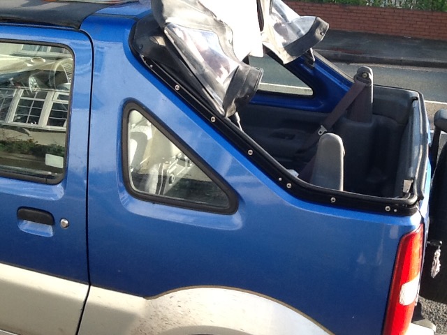

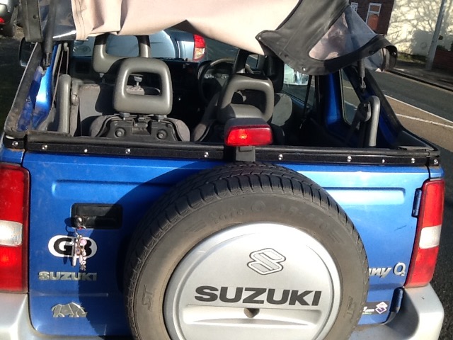

I have searched the various threads but haven't found the answer ....but I bet someone has .
Has anyone done a template for the steel bar that the Velcro is on with the rivets to lock down the back of the soft top ..and sides if possible .
Mine is now not even history ...there is an essence it was there and a few presstuds remain.
It is obviously just a bar with Velcro on but the mounting points for the bolt holes need to be correct ......so Before I remove what's left I was hoping ( best moulder and skully voice ) the answer is out there.

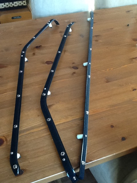

An update in case there are others in need!
It's been 6 months and the makeshift rear door section....which in all honestly takes some hammer , unclip, reclip ....repeat repeat was showing signs of slacking ......if the car wasn't a farm type workhorse it'd be less affected ..But we digress.
On Jimnybits site as a fairly new addition to their catalogue ....Velcro rails all 3 with poppers fitted £96 including postage.( £6 postage)
An inspection of the side rails and they were bodged by a previous owner , so. Bullet bitten.
Arrived next day
Fitted in about 15 mins each rail , studs married up from the off.
Value for money , even given I'm a tight *rse I say yep , no hassle finding bits , all bolts and washers included.( however the washers could do with being wider as the just cover the hole.) powder coated , they do the job . Now the hood is as tight as my wallet close.
