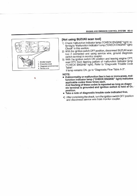

ok, just want to confirm the jumper lead for Monitor Coupler socket at the back of the glove box: : Workshop manual page 6E-13
The workshop manual is not greatly written,
Do you connect the terminal 2 (ground) to terminal 3 (diagnosis switch terminal). and count the flashes taking into account the pauses outlined.
is that the way. Thanks Owl.
