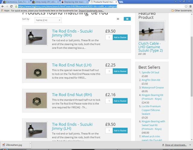

New tie rod ends are inexpensive Bryn -
Here in the BigJimny store that helps fund this forum -
www.bigjimny.com/store/search.html?searc...=tie+rod&_a=category
The process you describe is correct... use the old bar to setup the #new# bar with new tie-rod ends and replace it.
