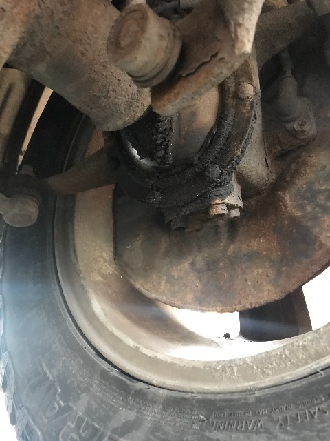

Hi all,
So, I am chasing death wobble gremlins around, following the advice on the wiki. I’ve started with wheel balancing and had that done, it helped slightly but not much.
Now moving onto kingpins and kingpin shims. (I’ve been researching!!)
So let me start by saying, my mechanical experience is very limited but I’m a good learner and instruction follower, before you answer my questions, take a deep breath and pretend you’re talking to a five year old who knows nothing about Jimnys...
Kingpins.
Checking for wear, any tips? I’ve read the guides but I’m not sure what exactly I’m looking for. I am wondering if mine have the leak it mentions I took some pics.

Yes the king pin bearing sets need attention going by the pictures. The test is to lift the wheel just clear of the ground and with a pry bar see if it moves vertically, not in the suspension button you should be able to feel it clunk. Alternatively try to move the wheel with your hands at the 6 o'clock position trying to push the top in and bottom out and vice versa.
The shims are tested with the wheel off and the steering bars disconnected from the knuckle. The knuckle should be able to swing smoothly through its arc of movement with not more than about 3.5 to 4.5 kg of force once the initial inertia is overcome. This is measured with a spring balance through the drag link hole.

You need the rubber swivel seal on when testing the kingpin tightness I believe. Get a new pair as they'll have had their day.
I don't think there's an effective way of checking if old ones are worn out or not. It's just a case of if they leak they really need doing.
