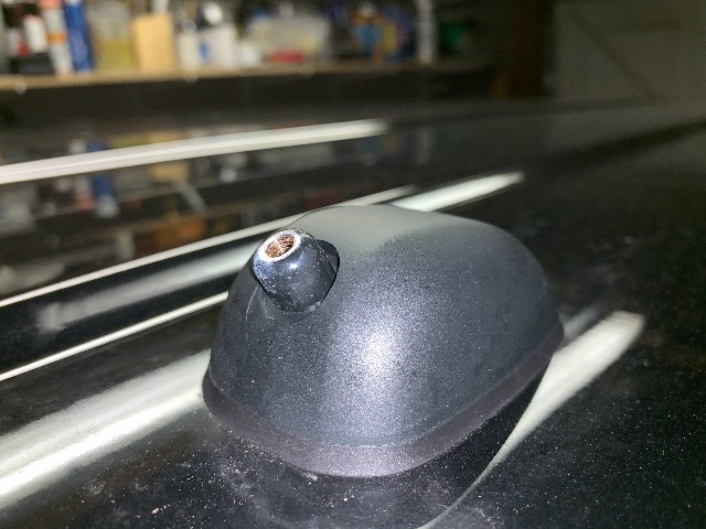

Can we get a closeup of the original antenna, and the hole in the socket/foot?

The Vitara has the same antenna, and I got to take a look at it today. As far as I can see, the gap is more or less cosmetic. Didn't look like the original antenna created a seal.

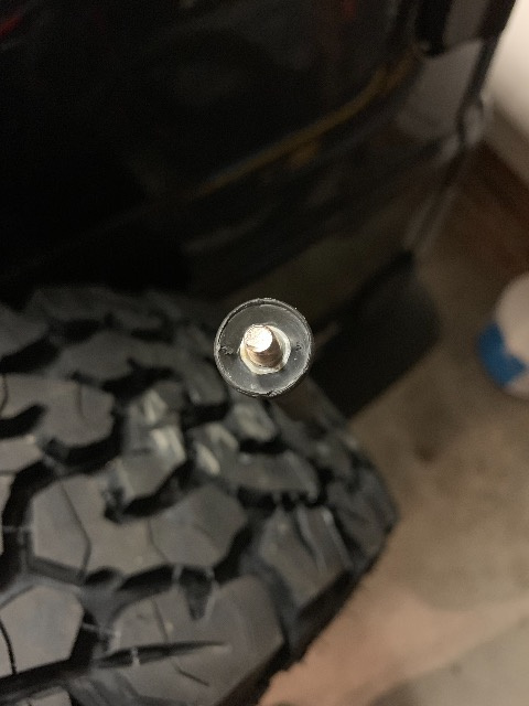

Here is the original antenna where you can see the deep recess as opposed to the replacement. The standard antenna completely covers the attachment nipple and has a good interference fit (it squeaks when being screwed in or out)
(apologies for the poor quality photos, I was in a rush at the time)

Have any of you found a kit like this: kufieta.com/offer-1/universal-car-antenn...-joint/#!prettyPhoto
Take the joint from a kit like that, and you can lay the antenna pretty flat.

Thanks George. That would do the job and I guess we would want some kind of flexible shroud to go over the top. Hopefully someone will make one in the right size.
