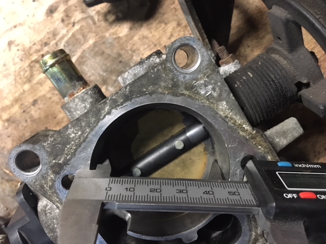

Some differences in the look of the idle control valve, but the part itself looks interchangeable. The throttle position sensor has a different plug, so some thinking needed there. The rocker cover breather on a Rav4 is connected to the throttle body, so that will need blanked or altered. Bolt spacing is also different unfortunately.
OK so back in the workshop out of the weather for a better look:
Jimny:
Rav4:
So a fair improvement (46mm to 55mm). I need to measure the Liana one in J999MNY now :huh:

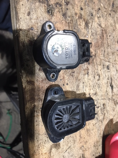

Anyway, measured the resistance values on connections of the two different throttle position sensors (TPS now on...). The Jimny one is mikuni and has different readings to the Rav4 one which is marked as Toyota branded. Not going to work with the ranges I recorded and the Jimny ECU. Need to swap them over then. Looks simple enough :laugh: Famous last words!
Look the same from the top down and even fits on, but the orientation of the thing is wrong for the spindle that operates it
Cue much messing about with tiny bits of metal to make a cross onto the throttle body part of it, screw it down to keep it all together and measure the resistances at different positions. Some preloading needed to get closed at the correct readings, hence the odd angle it now sits at...

Jimny:
Rav4:
