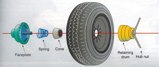

The equipment often used is like the yellow rubber retainer show here

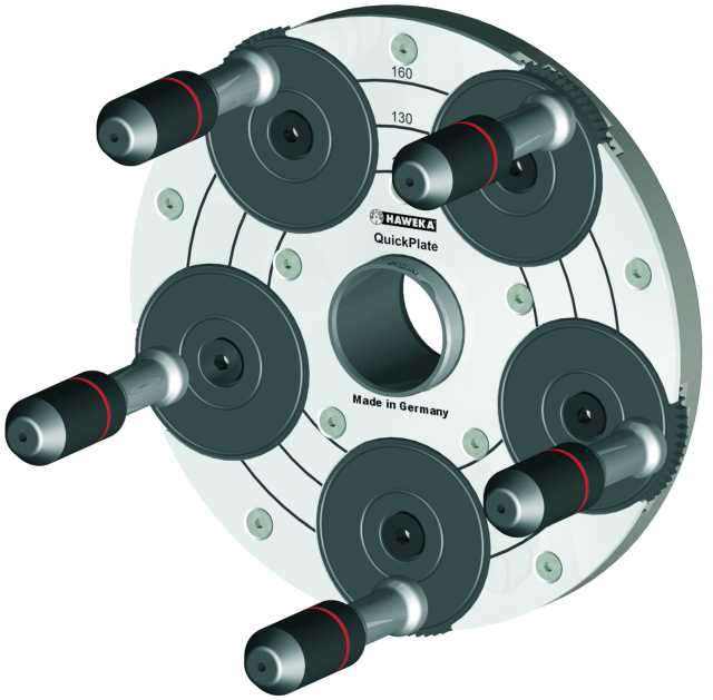

and, from what I saw, was near impossible to get it to sit true on the face of the Jimny wheels. The tighter it was done up, the worse it got. The second tyre fitters I went to also tried using this method, and then used something like this
To be fair, the original fitter might not have realised that it was not mounted true (doing dozens of wheels the same way every day), and was perfectly balanced for the less than perfect mounting.
Anyway, as Busta said, it wasn't what we know as death wobble, but I just wanted to highlight the issue I came across and not to dismiss wheel balance even though it might have already been done.
