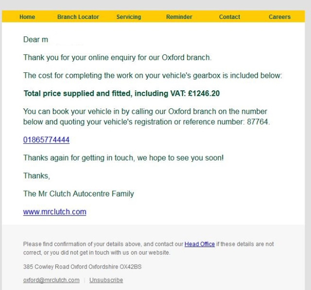

If thats the R72 gearbox, only a matter of weeks back I got a hypothetical quote for replacing the box on mine with MR Clutch . The Swindon branch changed my clutch a few weeks back for £250 which I thought wasn't bad as I neither have the time nor the facilities to undertake such a task
