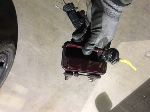

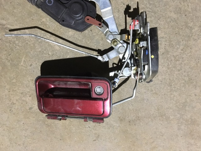

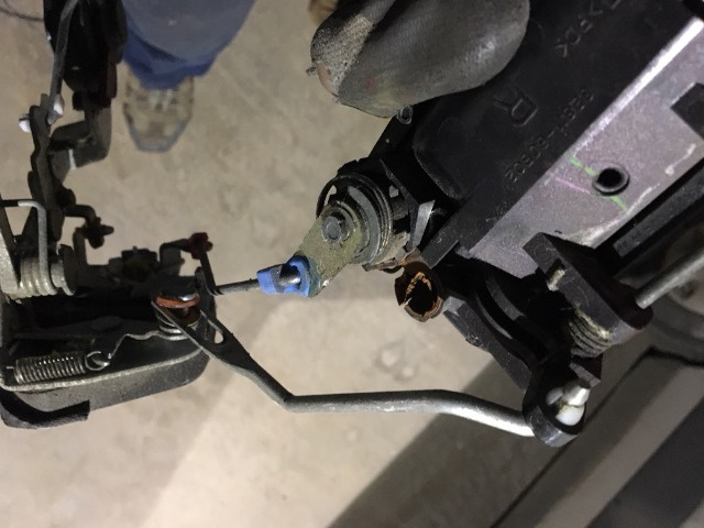

17 Nov 2018 17:26 #197723
Replied by Riccy on topic Rear door handle and lock replacement

Thank you very much for these pictures.
According to them, it looks like it would be quite a straightforward job to replace the "lockless" external rear door handle with the one with the lock?
Would you be interested in selling that one to me? The color does not match, but I've seen worse colors than yours (mine for example)
