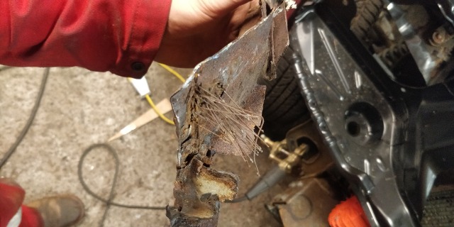

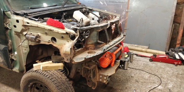

This is what I've done, decided to have at it with the help of some friends!
Removed this 'patch' from it.....

Probablynotfrank wrote: This is what I've done,
Good job.
It is such a shame when floors have not lasted.
