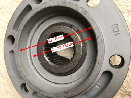

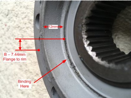

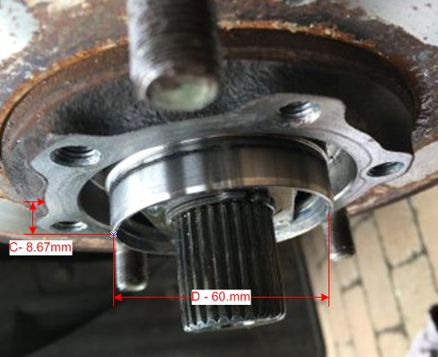

After all the posts this week (thank you all) I decided to do some more accurate measurements. I think this shows exactly why the hub is binding solid when the bolts are tightened.
Here is the existing car side showing the inner dia (D) of 60mm and that it protrudes (C) 8.67mm from the flange.
The photos below show the AVM side that must fit onto the above. Dimension (A) 57.45mm is narrower than (D) by 2.55mm. Given that dimension (b) is 7.44mm and dimension (C) is 8.67mm, some 1.23mm longer, its obvious that the binding will occur in the area indicated.
As a test I used 1.25mm washers to space out the two parts and no binding occurs. If others agree that their Jimny hub dimensions (C and D) are as mine then my AVM hubs would not fit them either. If so then there must be errors in the manufacturing of my AVM457 hubs and I should return them.
Also I cannot see how the locking collars are ever going to work given that they break up when tightened.
02 Jun 2018 16:46 #193154
by facade
They can't work, as those hubs have straight holes.
The conical washers are to fill up the conical holes that you haven't got. The head of the bolt stops on the flange, and the cone washer compresses into the hole, closing up the split in the washer .
Replied by facade on topic Re:AVM Locking wheel hubs
