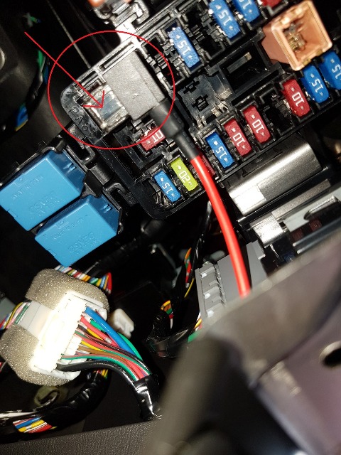

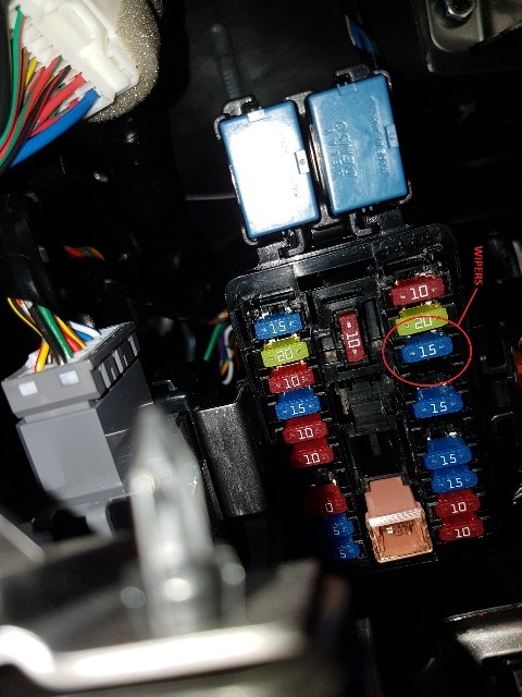

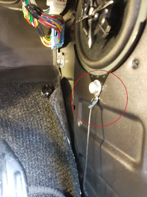

Hi and thanks. Yes the fuse insert does have a fuse on it. According to the instructions is piggybacks a fuse that is used once power is on. I've wired it into the washer (wiper) fuse and earthed it to the speaker screw that attaches to the main body work. All seems to work fine.
Below are some pictures of what I did in case it's any help to anybody, though I would add the disclaimer that I'm not much of a tech wiz like some of the folk on here. Anyhow I've always wanted to give something back to this fantastic forum!
Arrow in this image is the piggyback fuse unit. One slot seems to be for the power supply and the other is for the washer 15 fuse:

That's a neat solution. My only concern is that the wire feeding that fuse is rated only for the wipers and Suzuki haven't historically used the best quality wiring!

Oh. Do you think I should use one of those spare slots? I guess I could test if it is 'live on ignition' just by seeing if the cam has power when the keys out?
I can't seem to find an accurate diagram of what's live and what's not in the Suzuki manual.
The hard wire instructions did say the fuse it connects to doesn't matter as long as it's live on ignition? Do you think that can be trusted.
