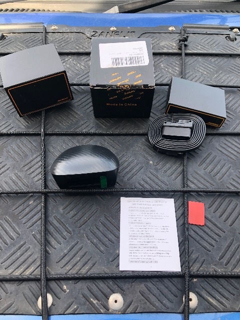

So it arrived -
In some very smart black boxes with an instruction book...

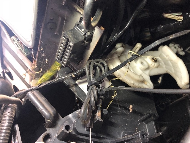

The OBD2 connector is just under the driver's left knee (on a UK model)
The plug just, errr, plugs in...

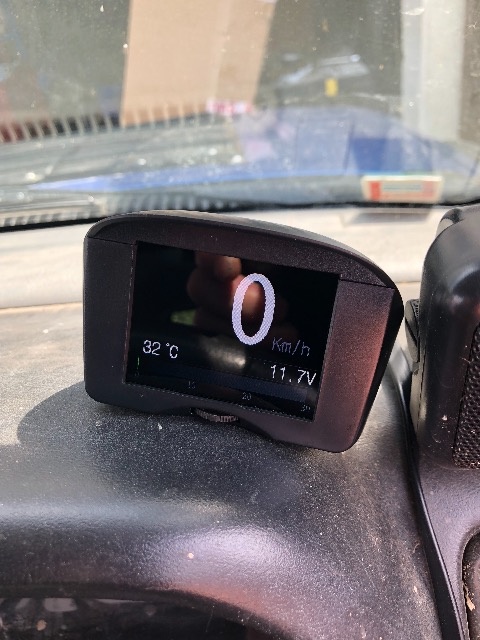

With the Jimny resting on the drive, 0 km/h*, 32 degrees ambient water temperature in the radiator and 11.7V coming out of the battery with the engine not running...
* this is easy to set to mph in the menus

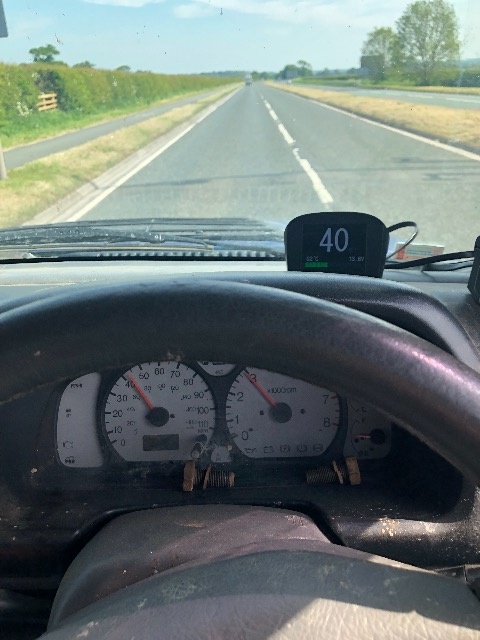

I had a run out and logged the speed against my iPhone running a GPS speedometer and changed the speed in the software to display at 104% which seemed about right
It was interesting to note that the speed from the OBD2 data port was different to that shown on the actual speedometer in the dashboard?! Although in the photo below it does read similar...
