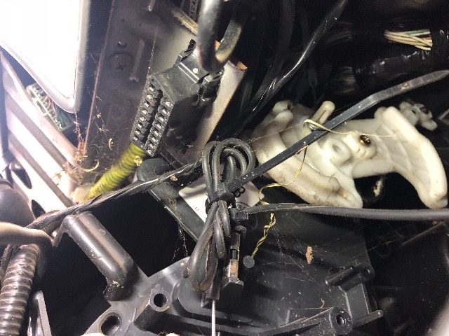

The OBD2 connector is just under the driver's left knee (on a UK model)
The plug just, errr, plugs in...

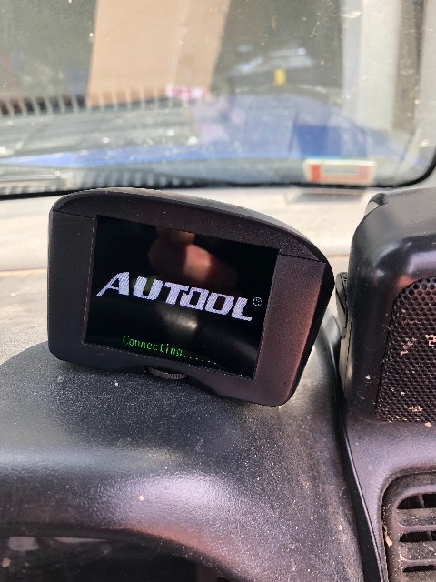

And the little device springs into life using power from the OBD2 plug, so no other power connectors or batteries are needed.

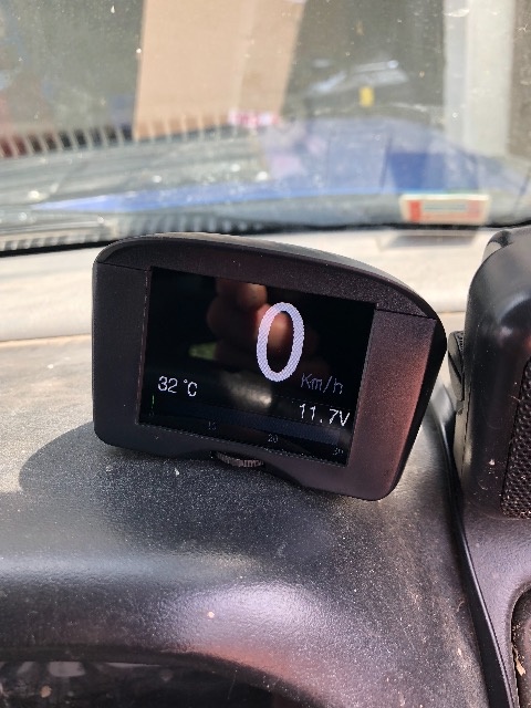

With the Jimny resting on the drive, 0 km/h*, 32 degrees ambient water temperature in the radiator and 11.7V coming out of the battery with the engine not running...
* this is easy to set to mph in the menus

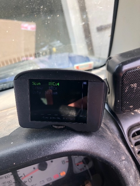

Not a great photo, but this is the error code reader section of the software (no codes present

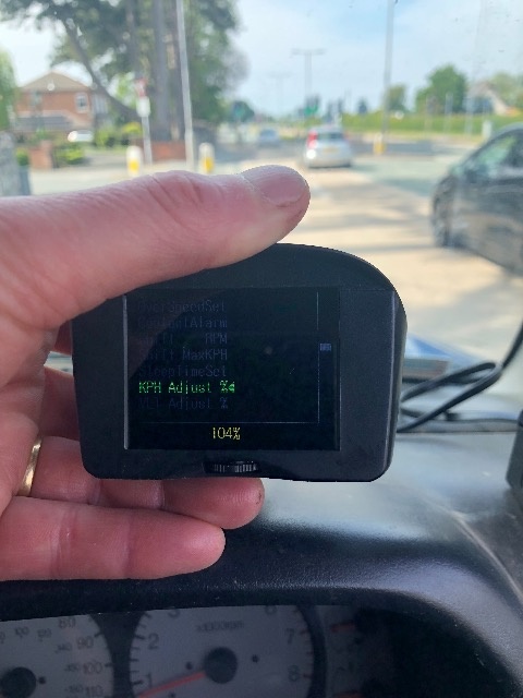

I had a run out and logged the speed against my iPhone running a GPS speedometer and changed the speed in the software to display at 104% which seemed about right
It was interesting to note that the speed from the OBD2 data port was different to that shown on the actual speedometer in the dashboard?! Although in the photo below it does read similar...

How much was it? And does the obd2 port live there on all models as mine is a 2001?

I paid a bit over the top at £39~ but it was from a UK seller and was delivered quickly... they are available cheaper...
Hmmm, I don't know when the change to OBD2 was made... someone more knowledgeable will be along soon
Where's Rhinoman when you need him
- Posts: 3727
- Thank you received: 923
21 May 2018 20:51 #192849
Replied by X8GGY on topic Review of Autool OBD2 Reader / Display
Old thread on the OBD2 question -
www.bigjimny.com/forum/6-jimny-chat/4443...have-obd2-ports.html
The port looks like a scart TV socket.
