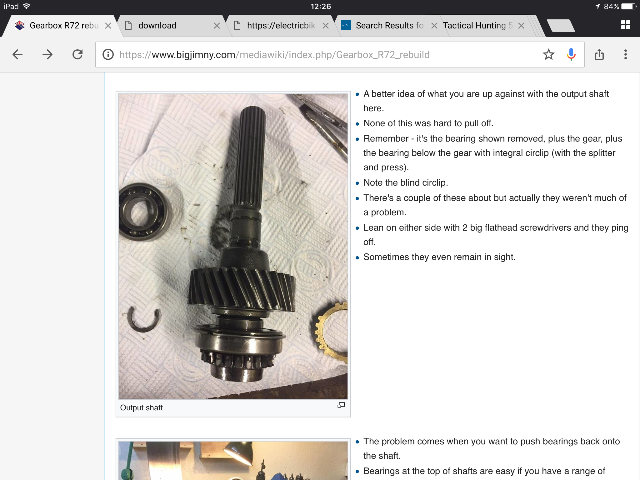

I am well underway on rebuilding the gearbox but I have one question and want to clarify the Bigjimny wiki article on the rebuild. I have replaced all the bearings but the ones on the output shaft.
The screen print from the wiki page shows the shaft and bearing in question. If I have it right the top bearing (already removed in picture), gear and bottom bearing all come of the top of the shaft one after another?
Just want to double check as its not very obvious looking at the shaft.
Thanks Sam

Replied by OlaGB on topic R72 Gearbox Output Shaft Bearing Removal
Yup, they all gotta go to get to the bearing.

27 Mar 2018 21:49 - 27 Mar 2018 21:50 #190942 by ZukracerV6
Replied by ZukracerV6 on topic R72 Gearbox Output Shaft Bearing Removal
Thanks, your help is appreciated!
All of the bearings have now been replaced and the gearbox is now being put back together. Rebuilding the box was far easier than taking the engine/gearbox out! All this because of one knackered bearing.
