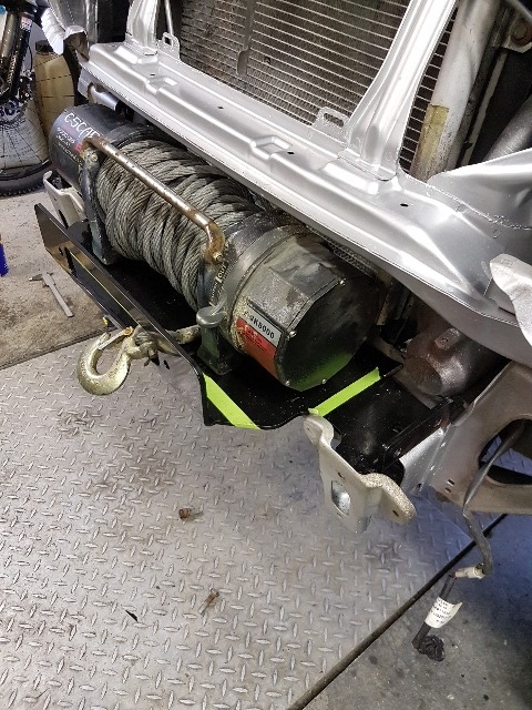

06 May 2018 08:59 #192433 by OlaGB
Replied by OlaGB on topic Jimnybits winch cryb, anyone got pictures?
I`m installing the winch now, and it looks like i will be getting it close to flush with the bumper, if i use a glider fairlead.. So probably going for syntetic rope..
Moved the winch as far back as possible, and will be moving the fairlead mount wall 35mm back now..

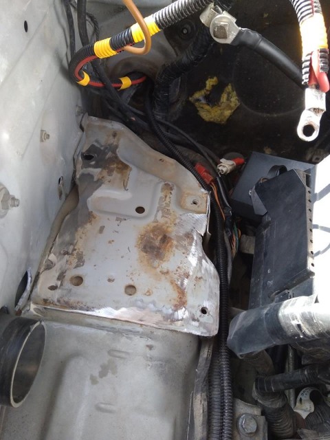

But the next obstacle, is where to install the solenoid, as it is kinda big..
Dont want it sitting in the rain/dust/salt in the front, so aiming for alittle more protected place. (not that there is room in front without cutting frame members)
Where have you guys installed youre solenoid?
Drilled holes, measuring cutouts for bumper and where to cut off the fairlead mount:
The solenoid is kinda big.
This is the only place where its actually room for it.. But i dont know if i can drill holes there yet.

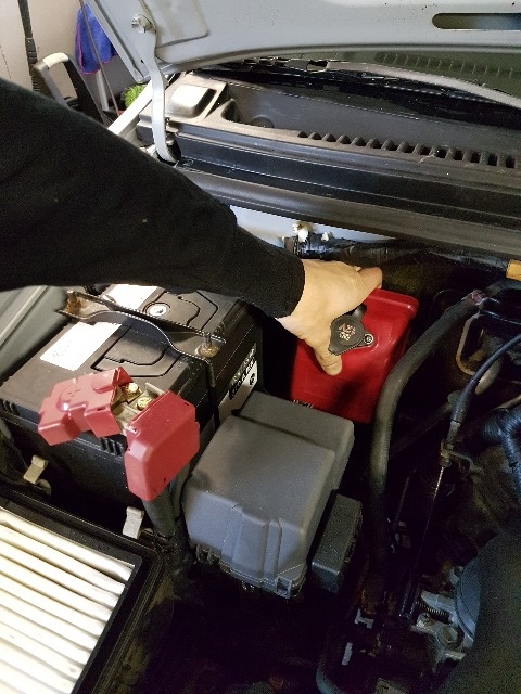

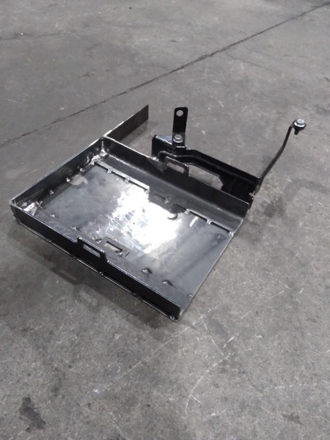

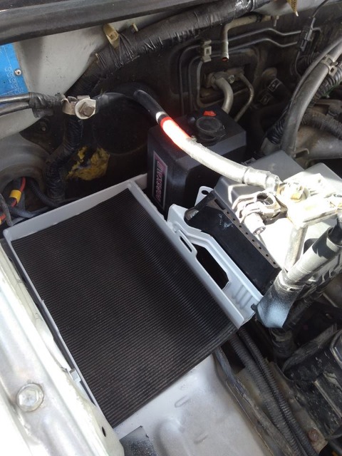

  • Mraz
06 May 2018 19:13 #192447 by Mraz
I had the same problem and I also needed a bigger battery so I've made this.
