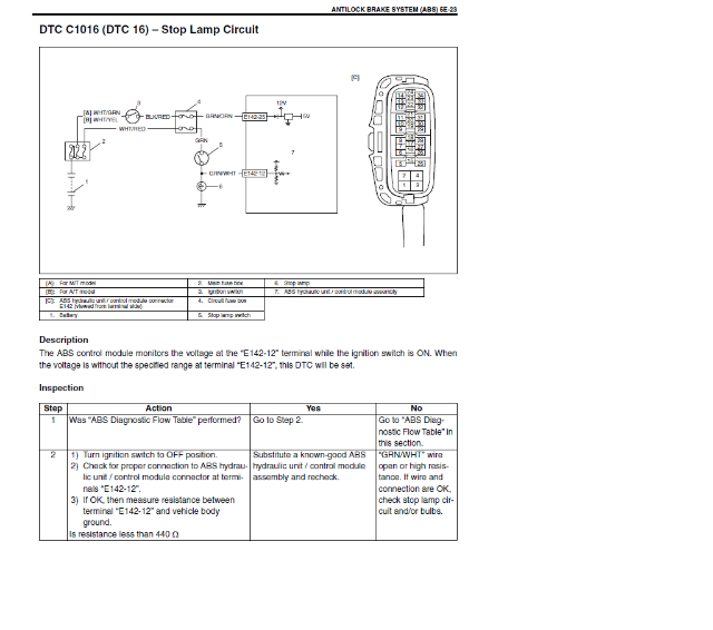

28 Jun 2017 05:20 - 28 Jun 2017 05:22 #182353
Replied by mlines on topic Help!!!! ABS Light ....
Last edit: 28 Jun 2017 05:22 by mlines.
The following user(s) said Thank You: ZukracerV6
- ZukracerV6
28 Jun 2017 14:37 #182363
by ZukracerV6
Replied by ZukracerV6 on topic Help!!!! ABS Light ....
Martin, your right on the money!
I had found that page you posted last night, and after some real head scratching and then I started to realise the only thing I had done different to the standard Jimny was fit LED bulbs. I had done this because the rear tail lights are sealed behind a perspex cover and very tricky to access. The idea being LED's have a less likely chance of failing etc! Little did I know it was going to cause weeks of sleepless nights!
A little googling late last night, found several posts about LED lights and ABS's warning lights on Asian cars. It seems that's the ECU carries out a check on the brake light circuit to ensure its working and looks for a slight load from the traditional incandescent bulbs but with LED's its cant pick up any resistance/load and goes into a fault mood switching the ABS light on!!!
Fitted a 50w resistor on the brake light circuit and ABS warning light now switches off!
With out my mates professional code reader, I would never have looked at the LED's and brake light circuit.
Sounds like you have come across this problem before?
Sam
Sam
