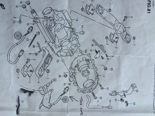

Well, I had some time this evening so I removed the switch to see if it can be soldered before ordering a new one from amayama (3763076J20 is the part number)
Here it's around 40 GBP.
I was able to solder the broken wire:
Added some liquid steel or whatever it's called to protect the soldering and the other wire :
Now the 4WD H/L works. I will give it some time before ordering a new part. It might last..
