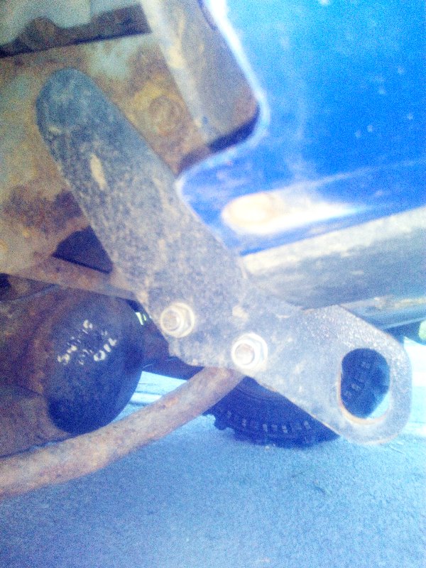

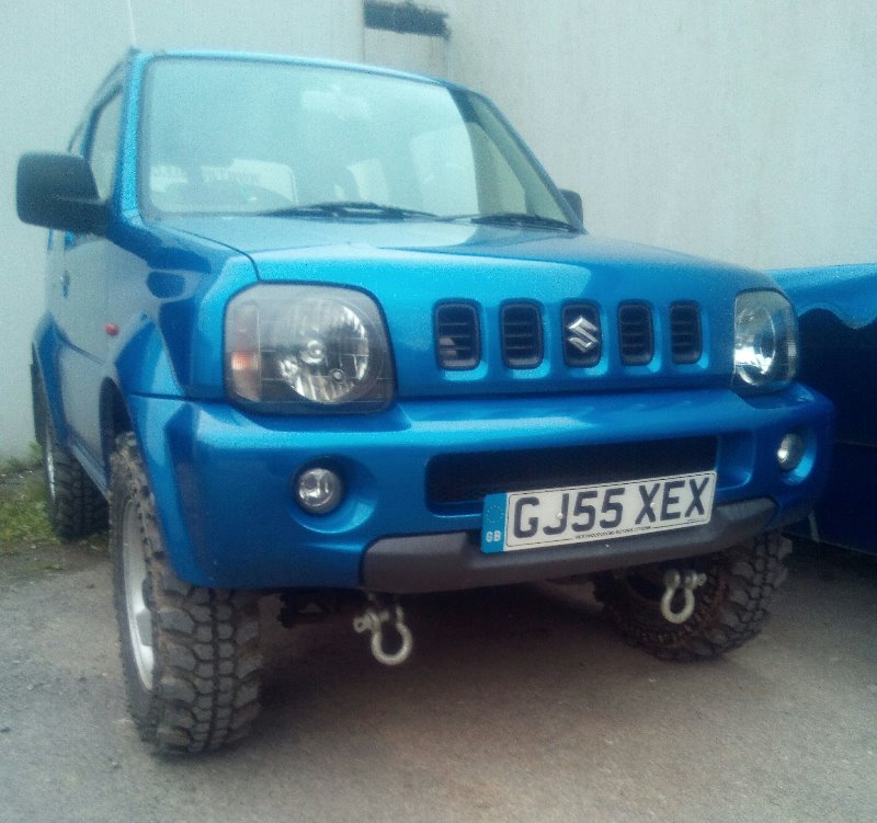

- 1066Boy
9 years 10 months ago - 9 years 10 months ago #175950
by 1066Boy
Replied by 1066Boy on topic Winch Options
I have used them all season in competition without problems. I like the design of the large round lug on
the end that slots into a pre made hole in the chassis. They are designed to come through the bumper
like most others. I did not want to make a hole so hung them low and bolted to the crappy standard points.
Not the best place and was thinking of moving them but have had them there all year without problem.
Cant remember the weight but around 1-2 KG approx.
