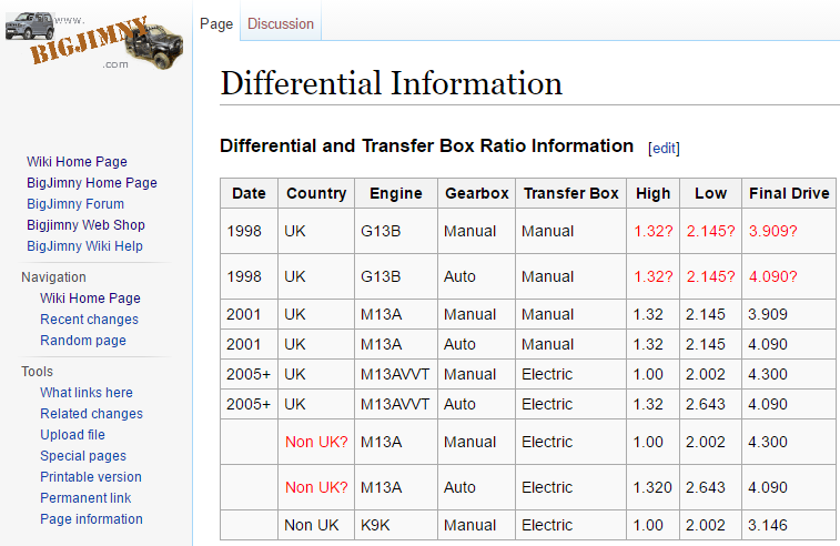

10 Jun 2016 10:47 - 10 Jun 2016 10:48 #168293
by Mr.m.y
Replied by Mr.m.y on topic Implanting 2008 A/T VVT transfer case on 2004 jim
Last edit: 10 Jun 2016 10:48 by Mr.m.y.
- Jokerax
10 Jun 2016 16:59 #168306
by Jokerax
Replied by Jokerax on topic Implanting 2008 A/T VVT transfer case on 2004 jim
Thanks for the info, but I already have it, I was asking regarding the swap procedure, not for the ratios.
