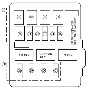

Hi guys, front fog lights have died
bulbs look OK
switch illuminates when on
fuse is OK = 101 below in supplementary fuse box below
but as I don't really know what I'm doing - don't know where the relay is ? :whistle:
also what's F/P RLY and FI RLY :huh:
thanks for any enlightenment

It might be part of the switch if genuine!
F/p fuel pump? FI fuel injection?

Mine did the same and the ground had come away near the air box, check that
