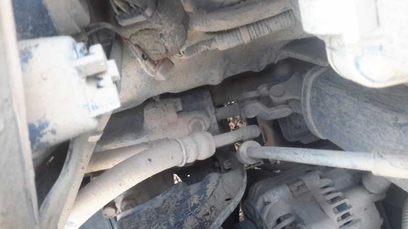

Evening gents. My jimny wont go on full steerkng lock. Nothings bent and i still have 3/4 lock to the right and 1/2 to the left. Went going across a field. Turned full lock left and there was a click about halfway through and then it wouldn't go full lock. I suspect something to do with the little motor unit thingy that the steering shaft goes into. Anyone got any ideas?

That's your power steering box
Were you in 4wd? It could be a broken cv

I was yeah. Milage is only 45,000 so its abit premature isn't it?

Sounds like a cv joint has gone, hard to say if its premature as depends on traction/grip at each wheel, and the forces generated on each wheel whist offroad

CVs can break regardless of mileage. Mine has had a few CVs and only done 23000 miles. Its the driving style that breaks CVs.
