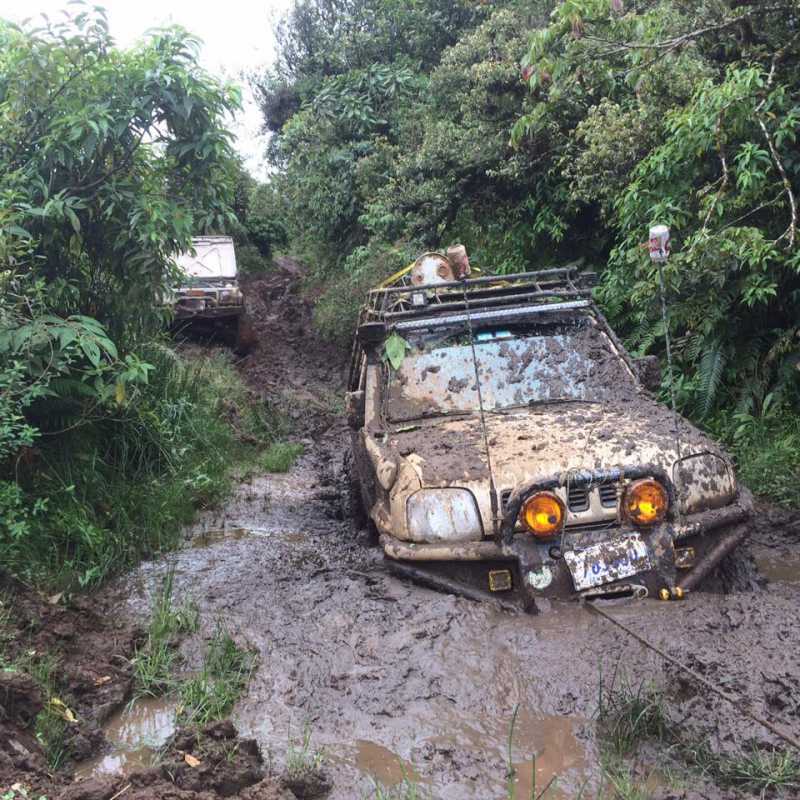

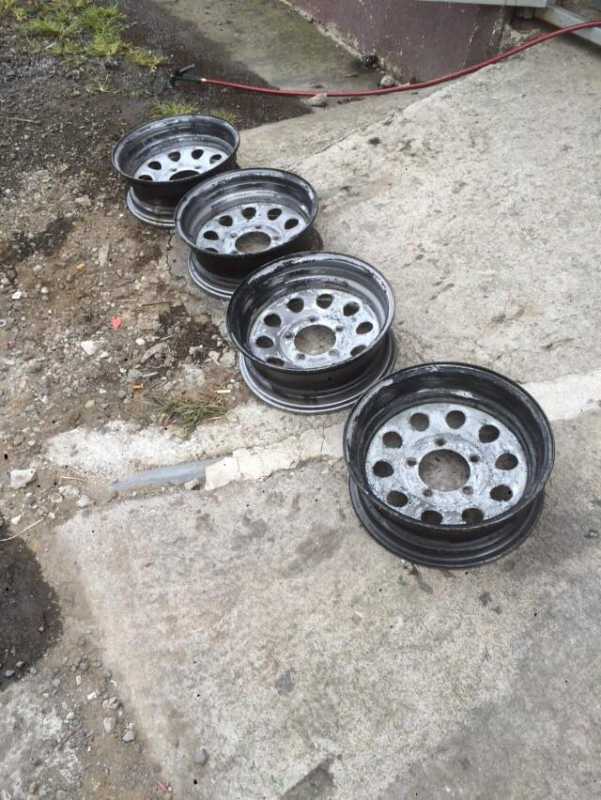

I took the original Jimny wheels, cut the center, welded it the other way around, welded the valve hole shut and made a new hole. I gained about 50mm.

sometimes I wish I had bigger tyres Daniel30 haha
